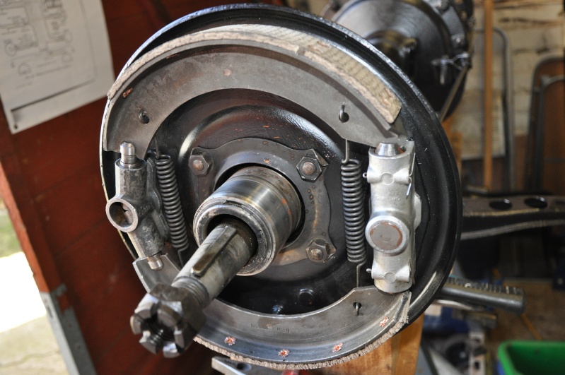

PostSubject: Re: Austin 12 New Ascot Project   Mon Aug 20, 2012 9:18 pm
Hi
I hope you are all enjoying the good weather and have been out and about in your cars. Mine is still a long way from being driven but I am doing what I have always wanted to do by restoring a pre-war car, so my time will come. My wife and I have christened the car Audrey after Audrey Hepburn as we feel it is a name that suits a car of this type and age.
I have, at last, found time to get the rear axle painted up in chassis black and it looks superb, even if I do say so myself. What do you think?
I wanted to start some reassembly so i needed to check a couple of points with the Austin Ten Drivers Club technical guru first. When I took the leaf spring off there was a plywood 'pad' separating the top of the leaf spring from the underside of the axle.
Apparently this is original and normal. However, he also stated that a better alternative was a neoprene pad, so I think it would be a sensible upgrade to do this. I am trying to keep as original as I can and I could put the timber back but I think there comes a point where alternatives don't compromise the finished product. i am going to try East Kent Trim at Worth to see if they can supply something suitable. I was also concerned about the shock absorbers originality as most of the books I have looked at show that they are of Luvax make with a more circular design. Mine are Armstrong lever arm dampers as below.
According to the technical advisor these are correct for the later cars like mine and therefore I am happy that they are original and also because they are in good serviceable condition I won't have to source replacements.
I was therefore happy to go ahead with some reassembly and thought I would start with the new bushes into the drop link from the shock absorber to the axle mounting. What a job! It took me over three hours and a combination of cut down funnels, long bolts, washers, clutch alignment tool components and jubilee clips before i got the bushes in. You might be able to see from the pics below that they are going to be a tight fit - the old bush is the one on the right of the two and the new one is substantially fatter. Then came the next issue of trying to get the drop link onto the shock absorber pin. The recommended solution is to use a bullet and push that through with the pin directly behind it. Not having too many bullets laying around I had to saw the end off an old nail punch to make my own bullet shaped guide. This worked and you can see the result in the second picture. Still, no-one ever said this would be easy and its all about improvising adapting and hopefully overcoming.
I just had time to start reassembling the brake back plate before I had to pack up for family duties, so although I didn't achieve what I wanted to, hopefully I have sorted the most difficult issue on this sub-assembly (don't tempt fate!). I am pleased with the way things are looking though and that some of the parts I was worried about seem to be original after all. Hopefully next time I will have more of it back together and can then start on the fuel tank. I am considering having the chassis blast cleaned to save time and ensure a thorough job, but I am still committed to using the chassis black rather than powder coating. I'll keep you informed in the next update.
Kind regards as always
Steve F.

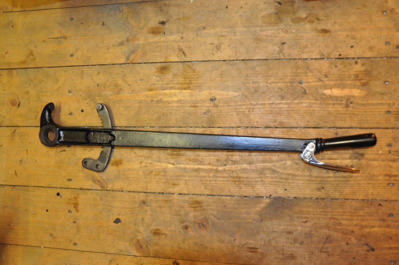

PostSubject: Re: Austin 12 New Ascot Project   Sun Nov 18, 2012 5:57 am
Hi all
Well, the rear axle is pretty much all back together now, just waiting for the two rear shocks and drop links to be returned from their overhaul by Stevson Motors, Birmingham. They called to say that the units were in very good condition for their age and just needed a service. The leak was caused by a core plug that hadn't been fitted too well.
In the meantime I have been busy dismantling the handbrake and footbrake assemblies from the chassis as I work forwards towards the front axle.
As
you can see the handbrake is a vertically mounted unit fitted to a
cross shaft in the chassis. It is also linked to the footbrake mechanism
and a further link to the primitive Lucas Brake Light Switch
The
large spring is a device fitted to these vehicles with the idea that it
would reduce rear brake 'snatch' and make the whole braking process a bit
smoother. I'll let you know how effective it is when I get the car on
the road!
Much of this part of the braking system is pretty seized up. Once I got
the handbrake and footbrake mechanisms onto the bench I started work to
reduce them to their component parts for a thorough clean up, paint and
re-grease. Easier said than done!. Initially I had to grind off one of
the handbrake mounting bolts that was well and truly rusted into
position. This then needed drilling out of the casing that houses the
end of the cross shaft. I had to use heat quite extensively to get some of
the nuts undone and, unfortunately, the adjustable yoke on the end of
the long brake rod running from the handbrake to the rear axle sheared
off when I tried to release it. It needed to be free to enable proper
brake adjustment when the system was complete. I will need to get one of
these rods turned up and threaded at a machine shop as they cannot be
replaced off the shelf.
The plan is to get this part of the braking system refurbished then take the front axle from the car to start on that. This will probably involve King Pin replacement and all sorts of other exciting challenges! The front axle looks a bit sad at the moment with its fairly liberal coating of surface rust and it will be good to get it into the dry for the winter. The chassis will have to stay outside under a sheet of damp-proof membrane until the Spring, when I hope to get that refurbished and refit the axle assemblies etc that I am currently working on. The rolling chassis can then be promoted to the garage and the body will have to come outside for work.
I have also been fiddling around with some minor pieces of interior trim to keep the momentum going. When I got the car there was no rear view mirror but I managed to find a cosmetically challenged one at Beaulieu this autumn for £10. I have just finished refurbishing this. I was going to get the original glass resilvered but this is expensive. Instead I had Ramsgate Glass cut one from the original as a pattern. Yes it is very slightly thinner but it only cost me £4. I have had to paint the back of the new mirror satin black as the mirror glass they cut for me had a bright green finish on the reverse, but I am pleased with the overall result and i still have the original glass which can be resilvered if it ever bothers me that much.
Ok. That'll do for now. I'll post another update soon when hopefully the handbrake assembly will be painted and looking a bit more like it should and maybe the front axle will be off the chassis.
Kind regards
Steve F.

Hi all
Sorry there have been no updates on here for so long. Truth be told, I have had to have some time away from the car through work pressures, setting up a new business and a bit of illness too. I'm back on it now though and hopefully picking up more momentum now.
So where have we got to. Well, the chassis stripdown was completed and it is now resplendent in gloss black chassis paint.
I have prepared various mounting plates and clips from the chassis ready to go back on and the next stage will be to start building up the chassis from the hundreds of pieces that I have got scattered around the shed and garage. It has been quite hard to get some replacement fixings as I am too fussy by half sometimes. The secondary wiring loom to the rear lights and fuel sender was carried in open P-clips held in place with 3/16 BSF cheese-head setscrews. Trying to find replacements screws is a nightmare but I've managed to find just enough on E-bay. Even TV Bond in Ramsgate High Street couldn't help.  You know you're in trouble when he can't sort you out. If you haven't tried him out yet he is a mine of information for the old threads etc.
I'm just waiting for the wheels to come back from Windridge Coatings. I had decided I wouldn't have any powder coating at all as it didn't fit with the vehcile's age. I was persuaded into this when I took the wheels there to be shotblasted. He is only charging me £35 a wheel for the full treatment and, as he said, it will give a more robust finish than paint and it will be hard to tell the difference. Saves me work too!  Hopefully I'll have some picks to add next week.
I've also finished off the D-light that I was painting a while ago.  I'm quite pleased with the finish but I'm especially pleased to have found some of the 'unobtainable' rubber shields while I was at Beaulieu last autumn.
Today I have been working on the engine mountings which are a bit sad. The rubber has gone a bit saggy and has separated from the mounting plate on one of them. Also, one of the fixing bolts has sheared off. I found a really helpful place on the Haine Industrial Estate at Ramsgate called Samson Challis.  They are into all things rubber (!) and he managed to supply me with some suitable offcuts of non-abrading rubber for £10. I now need to find a suitable bonding agent to keep the rubber and the metal together.  I have drilled out the sheared bolt and am in the process of fitting a coach bolt in to replace it. Anyone got any ideas on a suitable bonding agent? I'm thinking two-part epoxy glue but I'm going to do some research to find the most suitable one.
The front leaf springs are in the process of being refurbished as I have said before they need to go away as the zinc interleaving is coming out and I am hoping they can be checked over and refurb'ed by a company called Rossendale Road Springs. Hopefully they can help and will turn them around quite quickly.
I'm glad I've got the bug back again for this project.  I don't think I ever lost it but other things got in the way and it became too easy not to find the time. I will try to get more regular updates on here now as the project turns a corner and I start to fit up the chassis once more. I will be pumping it full of Waxoyl before I do this so that will be the next job then it will be some of the rear axle and suspension to go on next.
see you soon
Steve F.

Hi all
Time for another update.
Last time I left you with the news that I was going to send my front leaf springs away for a refurb as the zinc interleaving was coming out. While I was getting some quotes it became apparent that the interleaving was going to be discarded by all of the companies as it was not something that was required anymore.  All of the companies would be retempering the springs and painting them up for me and the cost was variable between about £150 and £200 including VAT.  I didn't see much need for the springs to be retempered and sone of the companies even said they appeared to be in good condition from the photos. That meant I was paying out up to £200 to have the zinc interleaving removed. Didn't make a lot of sense to me so out with the Dremel and a handful of rather fragile cutting discs and the protruding bits of zinc were cut off.  The springs were then wire brushed and cleaned before rust treatment and painting in two-pack chassis black. They look fine and I have no reason to think they won't be good enough for the job.
I have also finally painted up the steering mechanism and fitted the new track rod ends which look good.  The mechanism also moves feely.  I agonised over this as well, as the track rod end I have fitted are after market stock not OEM.  The originals that were still on the car are repairable with new shims and rubbers etc but I am going for practicality here rather that complete originality. I have kept all of the originals so that if the mood ever takes me, I can rebuild them later.
As I had decided not to spend money on the front springs, I sent off my front shock absorbers for refurb instead. I had used a company called Stevson Motors in Birmingham for the rears which were Armstrong Lever Arms. The front shocks were Luvax of a rotary design.  This is the correct set up for this car as it was a transition model between the older 12/4's and the new alligator bonnet Austin 12's from 1939 onwards. Stevson's had made a good job of the rears, although they lost them for a while, but no such problem with the Luvax shocks.  These were, again, pronounced to be in pretty good shape, which is fortunate as they can be a bit expensive to repair.  Mine were duly cleaned, serviced and painted and sent back in double quick time for a reasonable £165 (+ the dreaded VAT). I'm pleased with how they look and they feel smooth in operation.
I have also got the wheels back from Windridge Coatings after their powder coating. They were put through the incinerator to burn off any old crud that was still on them, then blast cleaned before powder coating in gloss black. They look awesome
I have found a slight problem while starting to rebuild the chassis. I left the Metalastic bushes in the chassis as I didn't want the bores rusting. The bushes in the springs came out well using an oversize and undersize socket with a coachbolt through the centre. Winding the nut onto the coach bolt drew the bushes out nicely.  Not so on the bushes in the frame. After much eye-popping, swearing and sevral coahbolts shearing off the bushes hadn't moved at all. I don't really want to use heat as I've already painted the chassis but its looking as though thats the way forward and I'll have to repaint those bits afterwards. I have removed the centre tube and rubber section from the bushes and just need to get the outer tube out of the bore. I'm trying cutting through the outer tube without cutting into the bore to try to release the grip it has on the frame. Its taking ages and defying my best efforts at the moment. I'll get there somehow. Any ideas anyone?
Ok.  That's all for now. I'll get those bushes out over the next few days with a bit of luck so I can fit the new bushes and start rebuilding the chassis. I want it in the garage for winter. Off to Beaulieu International Autojumble in a couple of weekends time (6th and 7th Sept).  Fantastic event.  Biggest autojumble in Europe I think. Hopefully get a new wiring loom ordered from there and find a few smaller bits. Update to follow soon.
Kind regards
Steve F.
